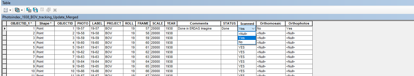

and I know it should work because I did in ArcMap. However, in ArcMap, you would have to use Editing Toolbar to enable to have the Attribute Table open and use the drop-down  to choose which  to populate from the list
See an example from ArcMap :
But in ArcGIS Pro, I was not able to see that and wonder why.  ? Did I miss something simple here ?

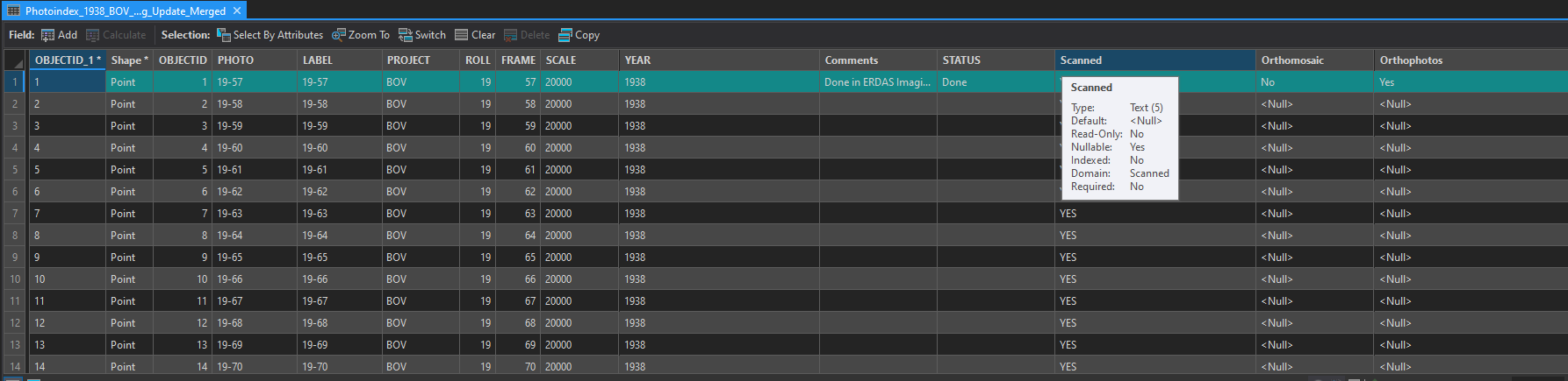

I highlight the layer that has these Domains  then open the Attribute Table to show the status of each Doman :

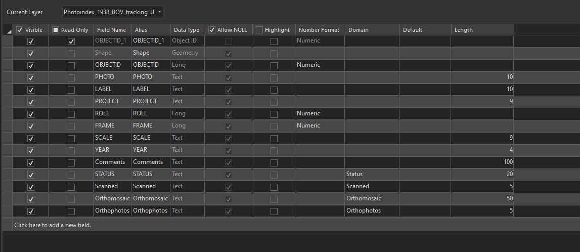

Screenshot of my Fields with Domains :
