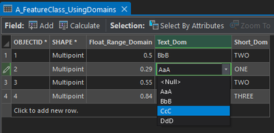

Here are two domains, one numeric, one text.
VinceE_0-1729782448283.pngVinceE_0-1729782448283.pngVinceE_1-1729782456302.pngVinceE_1-1729782456302.png
Here they are applied to a FeatureClass:

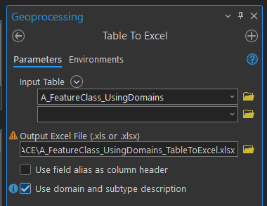

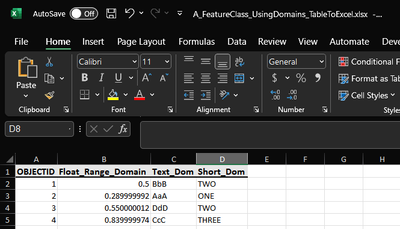

Exporting to Excel:
Export shows the descriptions, not the codes. This doesn't work for you?
