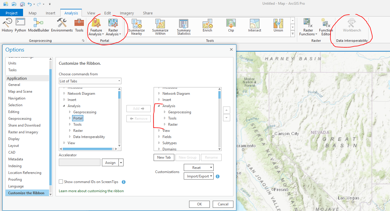

"each of the Analysis groups" How many are there? I'm trying to add a Group to the Analysis tab and selected the first one under MAIN TABS on the right. But it doesn't show up. Then I noticed that there are more than on Analysis tabs. Do I need to add my new group to each one? Where do these other Analysis tabs show up on the ribbon?
"There is some pending development work to improve the customize ribbon experience." That's good to know because I'm really confused about all these duplicate tabs that are all MAIN TABS!
I just realized why there are multiple tabs, one for each view, map view, layout view, etc. But it would be REALLY nice if we could tell which is which when looking at the right hand column in the Customize the Ribbon window.

There is some pending development work to improve the customize ribbon experience. To answer your immediate question, you can find each of the Analysis groups under the Main Tabs part of that dialog, and remove Portal and Data Interoperability from all of those. Then they will no longer be present on your Analysis ribbon:
These changes should persist - when I open a new Untitled project, my Analysis ribbon is how I want it:
About the custom ribbon, how do I remove the tools rather than have it grey out. Also I can't seem to remove the Portal section and does this revert back to the default when opening a new map? I'm using 2.4
Thank you for your help Kory
