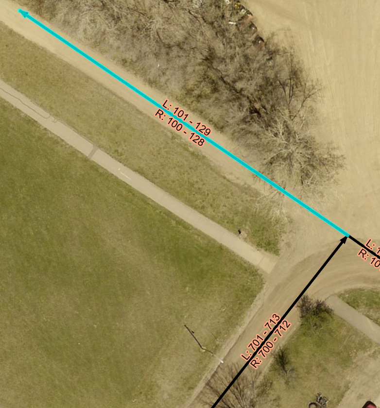

Hello,
I have a street that I would like add a stacked label with the left and right address range.  the labels appear just fine when the direction of the road heads towards the East.  However if the direction of the line heads West then the left range is displayed on the right side of the road.  I can select the "Align label to direction of the line" label position however, that creates upside down labels.
Is there a way to do the following:
  • Create stacked labels that straddle road centerlines.
  • Always display the left address range on the left side of the road.
  • Always display the labels upright and never upside down.
Thank You!
Figure 1:  The Left address range is displayed on the Right side of the road for the selected feature.

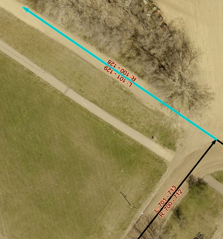

Figure 2.  The left address range for the selected feature is displayed on the left side of the road.  However, the road is upside down.
