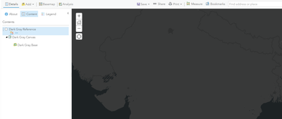

Hello, anyone know where I can switch off the labels of the background map in ArcGIS Pro Portal? I can't find it anywhere. Thank you in advance and best wishes. ArcGIS_Portal.png

Hover your mouse near the sub-layer "Dark Gray Reference" > Click on the three dots (...).
Click "Remove" to remove the reference layer.
Alternatively, click "Move from Basemap". It will come out of the basemap, and you can toggle it on/off. Later you can do a "Move to Basemap" to again make it a part of the basemap.

Thank you it worked :)!
