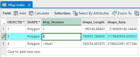

Before:
Double click the cell. Hit the delete key. Press ENTER.

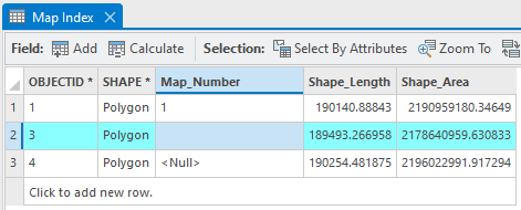

After:
I'm surprised that the deleted value resolved to Empty, instead of null.
In comparison, an enterprise geodatabase like Oracle would have resolved to null.

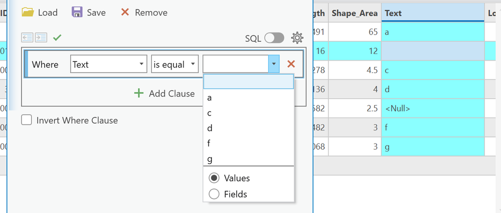

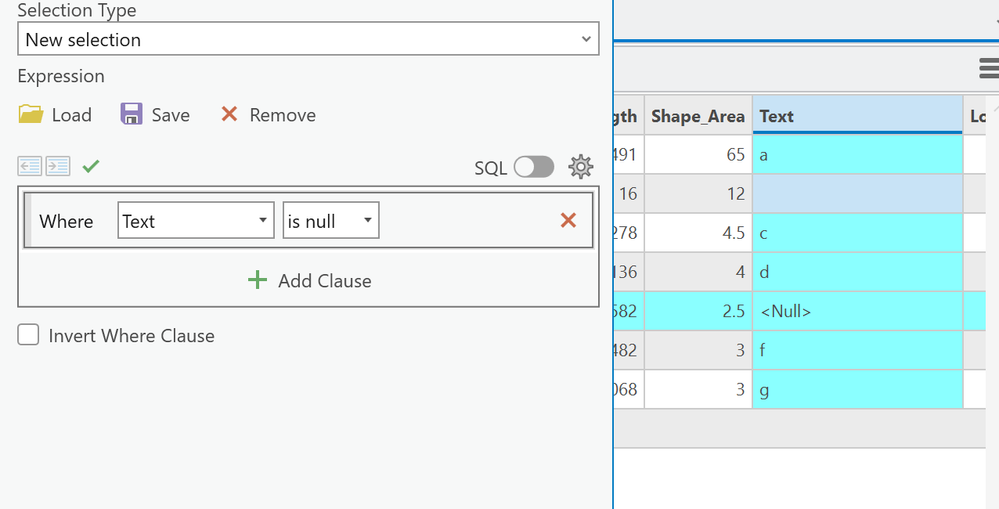

  1. Is setting a FGDB value to Empty really a good design choice?
  2. Is Empty the right terminology? Or is it something else, such as a hidden space?
  3. How would we query for Empty values using SQL?

Because it is an empty text string not None.  There is a difference.  There is only one None.

I guess I'm just more familiar with Oracle EGDBs. In Oracle, there is no concept of None or Empty. Only null.

Null is None by another name.  An empty string is a different object, it exists as a string just with no characters.
Think of "None/ <null> " as the object that has yet to become what is in the field.
