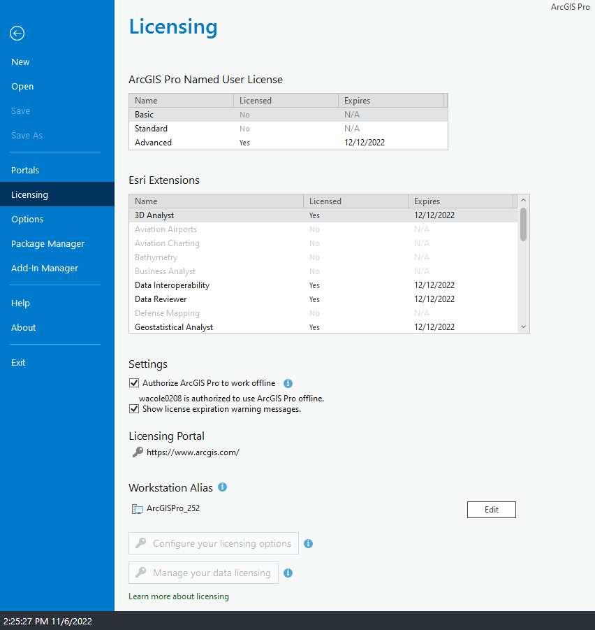

I found the document about how to deauthorize an ArcGIS Pro single-use license here.  [I'm moving to a new computer.]  However the instructions do not include version 3.0.  When I open my ArcGIS Pro settings page per the instructions, instead of seeing what's in these instructions I see:
ArcGIS Pro 3.0 SettingsArcGIS Pro 3.0 Settings
Help please.  Thank you very much.

Good morning Bill - the first thing you need to do is uncheck "Authorize ArcGIS Pro to work offline" and check the license back in to your portal or license manager.  After checking the license back in, click "configure your licensing options" - then you'll see a licensing user interface that should track the Tech Support article you referenced.

Robert, thank so much.  Unfortunately the "Authorize ArcGIS Pro to workoffline" checkbox is grayed out.  I am unable to change it.

I sorted it out.  After carefully reading the little information tag next to the "Authorize ..." checkbox I discovered I had logged on with the wrong account.  Changed accounts and all is well.  Pro is now happily living on its new quarters.
