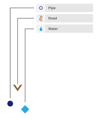

Hello,
When creating a label expression in ArcGIS Pro, I want to have my custom symbol, next to my label that has a background, and the symbol changes depending on the value in the data. For example, the light grey and red symbol would change depending on the type of feature it is.Screenshot 2024-03-11 130517.png
Essentially what I want to do is create the label in the following link, but instead of referencing a font symbol, I want to reference a list of symbols from a custom style that will be used depending on the value in the data.
https://pro.arcgis.com/en/pro-app/3.1/help/mapping/text/label-using-a-composite-callout.htm
Also if someone knows how to make a composite label like that as well, that info would be greatly helpful.
Thank you,
Ian

IanLadd_Tourmaline
Hi Ronald,
Yes that is an option but is very time consuming and often breaks as the label gets moved away from the symbol. I should have added that the image is the complete label and would show where the point is via a leader line like the following image. I ended up making label classes that way, but ideally what I would like is just to add a label expression in Arcade similar to the post that I linked to, where it sources the icon from a font symbol (I'd like to source an actual symbol) and I don't have to create 30 label classes. Which if I ever decide to change the color of the text background, I have to go in and change all 30. Do you know what I would code in there to reference a particular symbol from my custom style?
This is the code from the arcade expression and I replaced where I would need to reference my symbol:
function StormSymbol(code) { if (code == 'Pipe') return '<WHAT WOULD I WRITE HERE TO REFERENCE A SYMBOL FROM MY MASTER STYLE">×</FNT>' if (code == 'HU') return '<FNT name = "ESRI METEOROLOGICAL 01">Ø</FNT>' if (code == 'TD') return '<FNT name = "ESRI METEOROLOGICAL 01">Ö</FNT>' } `<PART position="top">${$feature.STORMNAME}</PART><FNT size='25'><PART position="left">${StormSymbol($feature.STORMTYPE)}</PART><PART position="middle">CAT ${$feature.SS}</PART><PART position="right">${$feature.INTENSITY}</PART></FNT><PART position="bottom">CATEGORY</PART><PART position="bottomleft">STORM TYPE</PART><PART position="bottomright">INTENSITY</PART>`
