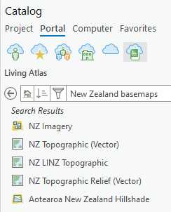

Pro has world wide imagery available under the Map tab --> Basemap command pulldown in the Layers group. Currency varies.
More options are found from the Living Atlas with details in the metadata.
BernSzukalski
Esri Frequent Contributor
The World Imagery basemaps (hybrid, and imagery) offer global coverage including New Zealand. Eagle Technology Group Ltd. (Esri Distributor in New Zealand) curates a collection of New Zealand specific content, including imagery basemaps with reference layers, that you can find by searching Living Atlas and choosing "New Zealand" from the region drop-down.
https://livingatlas.arcgis.com/en/browse/#d=2&rgnCode=NZ
