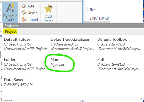

TomBole
HI TadeášDěd
You should be able to get the project name using the Name tag under the Project section of the Dynamic text gallery.

TadeášDěd
Hi Tom,
thank you for your comment. Yes, I know this is the option. However, Name tag represents the file name. I would like to call the project for examle "Průmyslový areál na zpracování odpadu - záměr D58575". I doubt ArcGis Pro allows me to name the project whatever I want. There is also no possibility to change it later. 😞

TomBole
I was able to name a project with the example you provided and the dynamic text element for the project name displayed this text as expected. Based on this GeoNet thread - https://community.esri.com/t5/arcgis-pro-questions/arcgis-pro-project-naming-conventions/td-p/544982 - it appears that there is a character limit on the name of a project - 260 characters. As long as your project name is below that you should be fine.

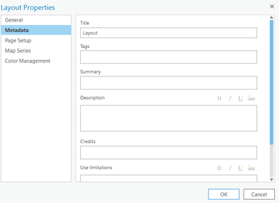

Thank you! I see there is almost no limit in naming the project (btw. Windows limit for the file name is 255 characters). Still, you cannot change the project name afterwards (the only option is to Save As to a new file). I think this is the best option I have for now. I will write this topic to ideas. The easiest option would be to have Metadata option for project (e.g. for layouts)
