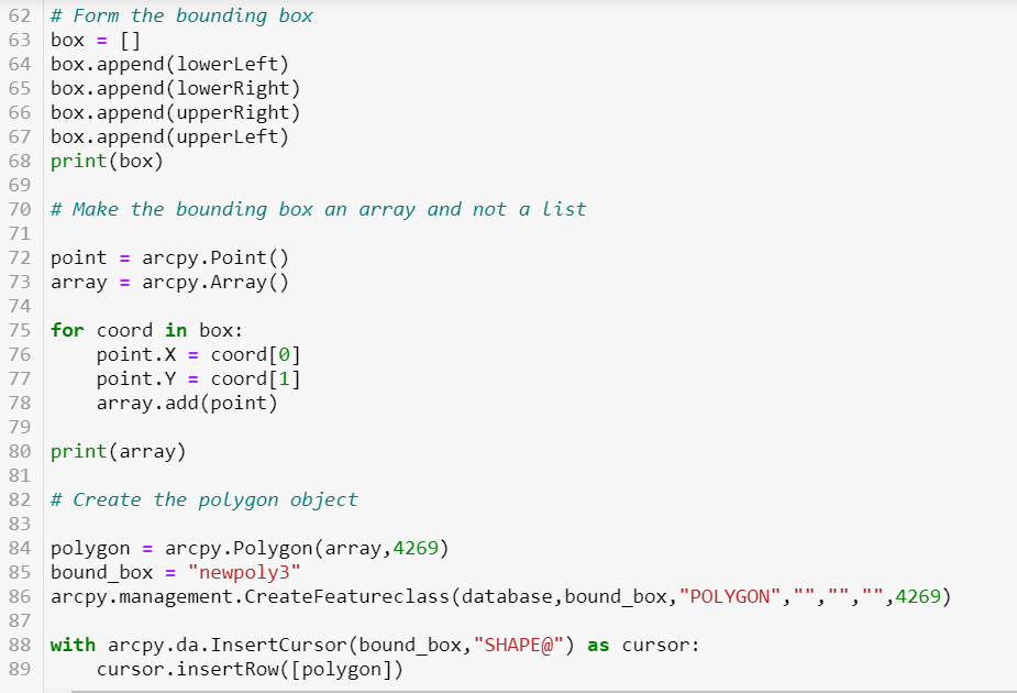

[Edited to correct mistype] I am doing a bit of coding with Python. Here is the relevant bit of unremarkable code to create a polygon object.
sr = 4269
polygon = arcpy.Polygon(array,sr)
bound_box = "newpoly3"
arcpy.management.CreateFeatureclass(database,bound_box,"POLYGON","","","",sr)
with arcpy.da.InsertCursor(bound_box,"SHAPE@") as cursor:
     cursor.insertRow([polygon])
This code reliably works when I specify the spatial reference in a projected coordinate system, e.g. 2249. However, when I set the spatial reference in a geographic coordinate system, e.g. 4269, there's an issue: the shape doesn't display. I went to Table of Contents --> newpoly3.shp --> Design --> Fields and checked the "Shape" box, but the shape still doesn't show up on my map. It's clearly been created; the attribute table shows an area and length. It just doesn't display. Anyone know what's up with it?

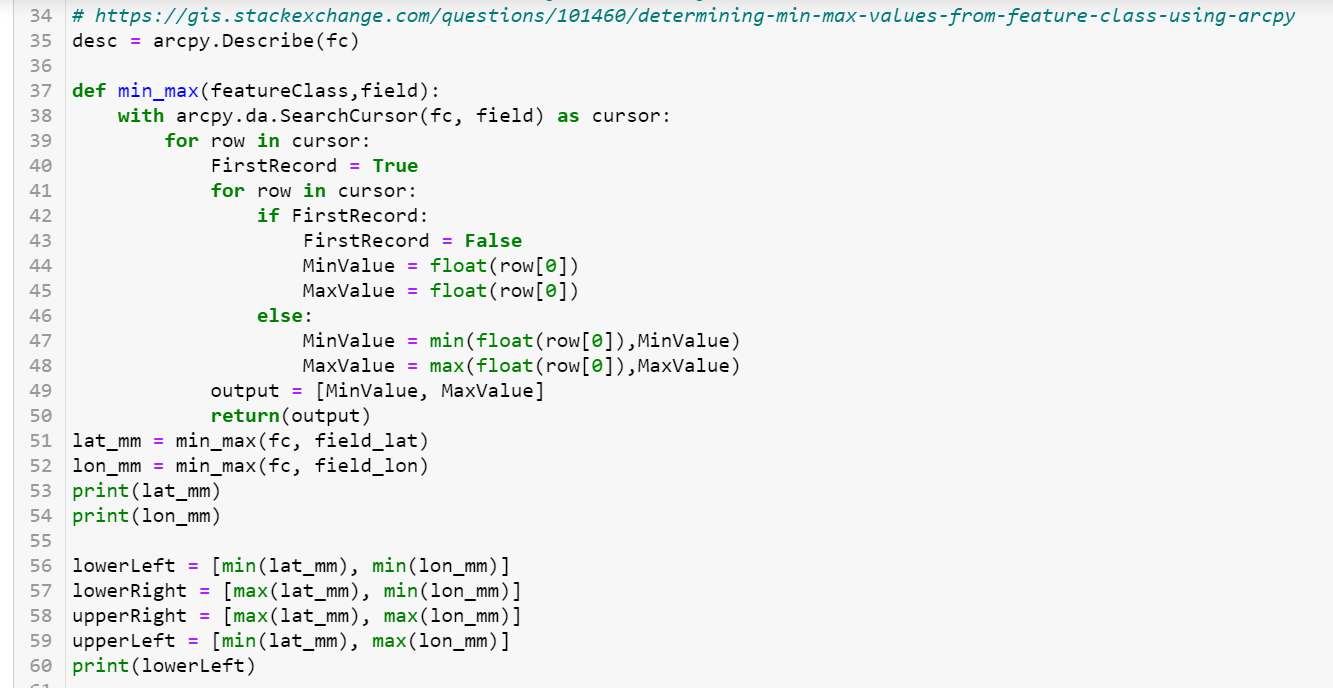

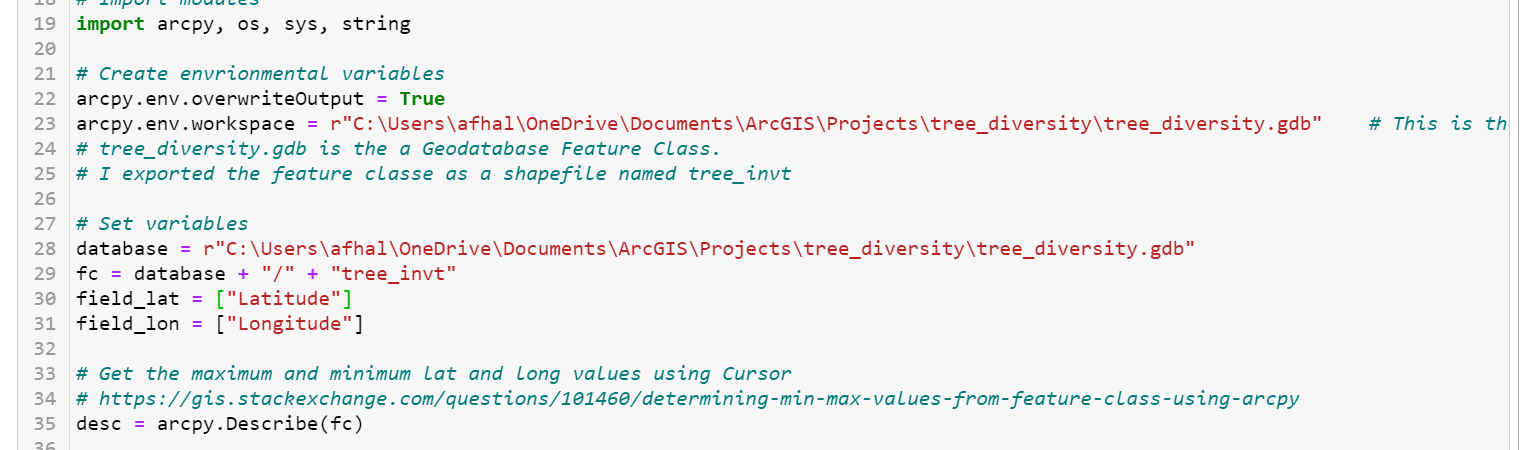

Here is the entire bit of code. The goal is to play with Python a bit and to form polygon from the x-y extent of a shapefile of points.

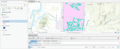

I think I'm not explaining clearly. Visual illustration:
The original layer file has two described coordinate systems. The projected one is 2249.
The geographic coordinate system is 4269.
"newpoly1.shp" uses the projected coordinate system 2249 and shows up on the map. Here is the Zoom to layer of "newpoly1.shp".
"newpoly3.shp" uses the geographic coordinate system 4269. (Same code, only difference is the number). Below is the "Zoom to layer" for "newpoly3.shp". As you can see (or not see), there is no shape.
The shape field is checked to be visible.
What I want to know... is why newpoly3.shp isn't showing up. Is it a matter of reprojection? I don't quite understand why, if so.
