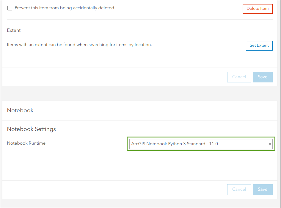

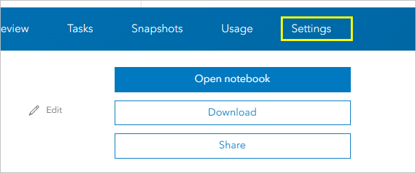

To change the runtime of a notebook, go to its item details page in your ArcGIS Online org.
Click the Settings tab.
Scroll down the page and click the drop-down list to choose a runtime. The latest version of the Python runtime for ArcGIS Online notebooks is 11.0
Click Save.
The new runtime will be applied.
