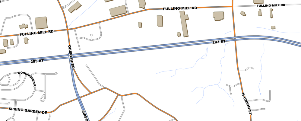

This is the "after" image where the ramp not longer display. The local roads (while fill) also disappear after zooming out a little more when they change to a single line. This is from a cache this week.
AFTER: the ramps are missingAFTER: the ramps are missing

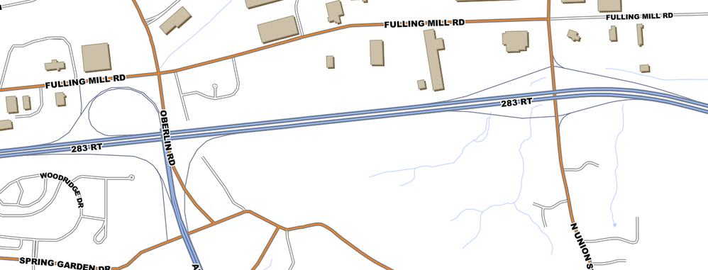

This is the "before" image where the ramps are displaying. This is from a cache I built in early march.
BEFORE: the ramps displayBEFORE: the ramps display

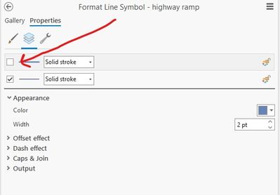

OK, I believe this to be an ArcGIS Pro 3.x bug. If a line symbol has multiple layers and one of the layers is turned off, that feature does not render in the output tile cache (OR, the symbol layer turned off is white, and does render, but since it's white, it is not visible on a white  background... I did not test this possibility).
Once I delete the disabled symbol layer, the vector tile cache output rendered properly.
