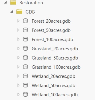

I was wondering if anyone have any suggestions/tips on how to create multiple geodatabases using modelbuilder? I would like to use modelbuilder to create all the geodatabases found below.

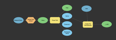

izk_1989
Hello,
You can also do this using Iterate Field Values tool, if you need to create them based of attribute values in a table.
