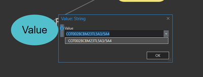

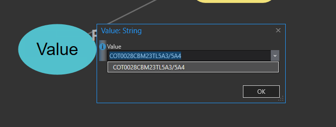

Value, which I assumed is what should be a list of all the values in the Site ID field from the input polygon
When I open the Value variable as you can see there is only one value
Any advice on where I am going wrong?
I've had this same problem - but have found a solution! Read here: Solved: Re: How to use attributes from specified field as ... - Esri Community
