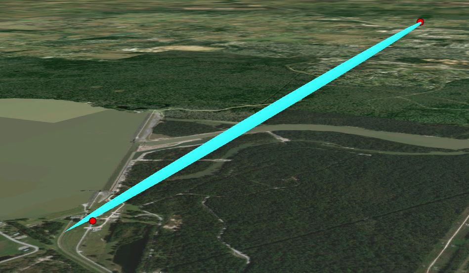

This picture below is the closest I've been able to get but it's far from usable. This will be used in 3D analysis so it needs to be spot on the locations.
The attempt pictured started with a multipatch sphere. It is pitched 90 degrees on its side and stretched using the modify/scale tool. I need some way to move the object so that it can snap to the points.
