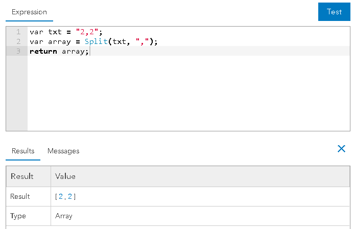

Hi T L ,
When you have a feature with a field called array (probably a text field) and you edit the field to type in ["2", "2"], it will not be an array. As Joshua Bixby asked, if you would put the text "2,2" (without the quotes) in a field, you could use the Split function to split the text up and create the array:

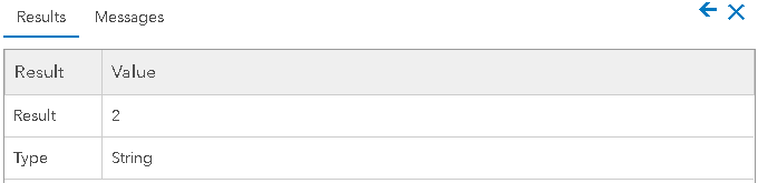

When you click on a "2" in the result, you will see that each element is in fact a string:

What does the string from the field look like? Is it something like "2, 2"?
