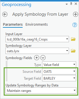

Hi Jayanth,
When you use the Apply Symbology tool, change the Target Field to the new field you want to analyze. Leave the Source Field to specify what was originally used to create the symbology. Make sure to choose Maintain ranges.
In the example above, I started by mapping my layer on the field OATS. Next I wanted to symbolize the same layer, using the same class breaks values, but with the field BARLEY. Result:
I hope that is the solution you need!
