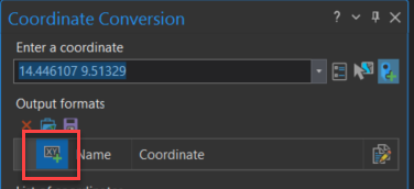

Hello, ...I don't think I'm understanding how the 'Coordinate Conversion' tool works; doesn't seem very intuitive. See below. So, I used the 'Map Point Tool' to click on a point. In the 'Enter a coordinate' box/List of coordinates box' -- where is it getting this coordinate system info? This is a New blank Map set to WGS84 Web Mercator auxiliary sphere. My Map Display coordinates are in Decimal Degrees.
Even so, I don't know what to do next in order to convert it to something else?
...The Help Doc didn't help, so any assistance is appreciated 😉 Thanks!

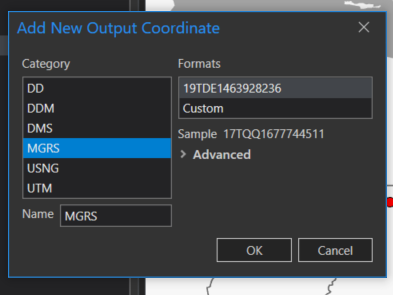

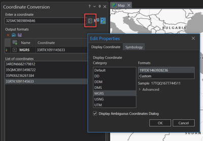

The enter a coordinate display can be changed by pressing the bulleted list looking icon to the right and selecting a new display.

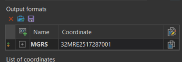

To convert your coordinates:
Click the XY+ Icon.
Then choose the output coordinate.
The new coordinates will appear.
https://pro.arcgis.com/en/pro-app/3.0/help/data/coordinate-conversion/change-the-display-of-input-co...
https://pro.arcgis.com/en/pro-app/3.0/help/data/coordinate-conversion/add-a-coordinate-format.htm

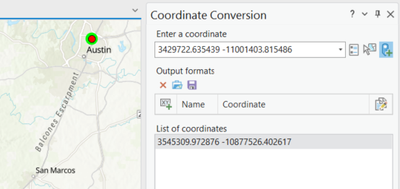

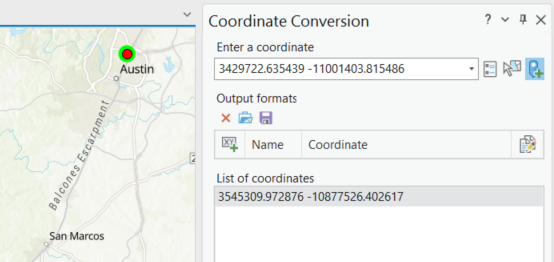

Thank you Jen, but my question was "what coordinate system is it defaulting to when all I have is a new blank Map?
I'm confused because my Map Display units are Degrees and the Coordinate Conversion units are definitely not.
