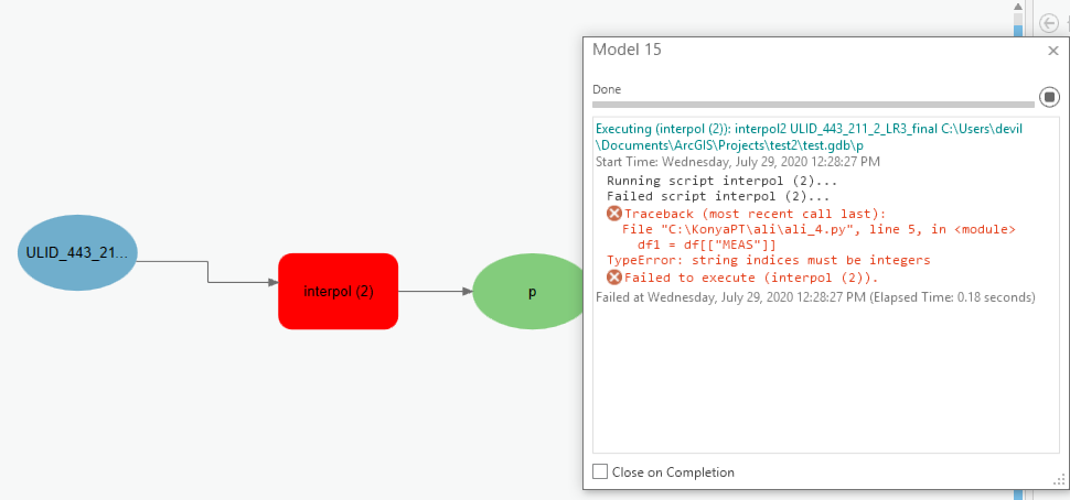

I already have a Python pandas code to use interpolation to calculate the time for Null cells. The input and output of this code is Excel(this excel comes from a shape file) file. Now I want to do run this code as a part of the Model builder in Arcgis pro. I try to use Arcpy but I face this error continuously: "TypeError: string indices must be integers".
In pandas, the attribute table automatically read as integer and matrix, so I easy search on two-column in data and then used interpolation to fill Null, but in arcpy it read it as String, so I cant search for any column, and I can't do anything to convert it.
as a summary: the code first read attribute table, then check"FS_TYPE", if it is equal to"STOP" then use "MEAS" and "TS" column to calculate "TS" of STOP. The code works properly in Pandas but I can't run it on Arcpy.

DanPatterson
MVP Esteemed Contributor
df is going to be a text reference not an object that you can slice on the second line.
Throw a print statement in there and see what I mean
