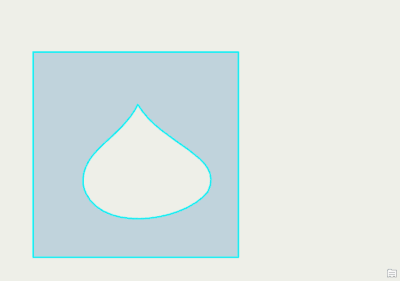

Scott_Harris
@AmieCarlone Can you provide a screenshot of this scenario:
but the problem is that the angle between the bezier curve handles on either side of a vertex apparently can't be adjusted or set
I also don't see a screenshot in your original post where you mention "see attached image".
I can make a smooth curve when I hold down CTRL key and then drag the bezier handles:
