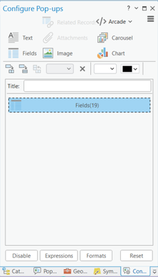

The explore button in ArcGIS Pro stopped showing all the attribute info on a ArcGIS layer. It shows one column info. I tried to configure pop-up but still the same issue. Can you help me with silly issue.
The Pop-up pane has a Top and Bottom section by default. The bottom section might not be visible. There is a grey bar splitting the sections that sometimes gets stuck at the bottom of the pane hiding the attributes. Hover the cursor over the grey bar if its at the bottom and hold down the left mouse button and drag the bottom up. Also note that there a couple of widgets (in orange rectangle) that can hide the top, bottom or split the pane.

Thanks Barry for your response. I still have the same issue after again trying what to said. The option 'Only use visible fields' option is on by default. It just shows what is on the 'Title'. Is there any 'apply' button?

Thanks much. It worked now.
