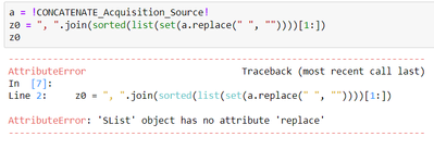

NathanBaier1
When I run this through notebook here is what it looks like:
Do I need to define the dataset prior to the field?

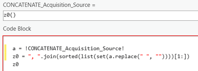

I have been trying that and I cannot get the format to work. Not sure if I have this formatted correct but when I make a = field I get an invalid syntax.
DanPatterson
MVP Esteemed Contributor
expression
func(!CONCAT....!)  # enter your field name... too long for me to type
code block
def func(a):
    return ", ".join(sorted(list(set(a.replace(" ", ""))))[1:])
... sort of retired...

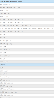

NathanBaier1
this expression ran but it did not produce the desired result. Instead of cleaning out it created a bunch of new coma delimited data.
