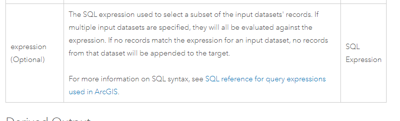

Have you tried Append using SQL to specify only certain attributes?
Append—Data Management toolbox | ArcGIS Desktop

Hi Kurtis - I'm assuming you've already read through the SQL reference for query expressions used in ArcGIS—ArcGIS Pro | ArcGIS Desktop help linked to from the Append tool help?
From the description you provided above, it sounds like you would want to append features where status = "completed"
 and maybe append to a different feature class where status = "not started" ?
I don't think you need to learn SQL - just use the query builder:
STATUS is equal to "completed"
STATUS is equal to "not started"
Does that get you going in the right direction?
