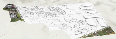

I read that since ArcGIS Pro 2.8 it is possible to use the clip function on SLPK Input-Data.
When I try to cut out an area from a SLPK file, the target file loses its textureand only appears completely white.
What I'm trying to do is cutting a very large 3D-Model of our city as an SLPK-File (63gb), produced with Agisoft Metashape, in smaler Tiles with 1km x 1km dimension, so we can use only the tiles we need in a project and make working with them faster than working with the big file.
But regardless of the size, the problem also occurs in smaller test projects.
Can I change anything in the settings or use a tool before or after cutting the data to restore the texture?

Thanks for sharing the slpk. As I suspected this slpk is missing required textureSetDefinition properties from the layer description. Because the clip tool does not fix invalid slpks it does not write out the textures because they are not specified correctly.
https://github.com/Esri/i3s-spec/blob/master/docs/1.7/textureSetDefinitionFormat.cmn.md
Besides going back to Agisoft and having them fix the slpk the only other option is to use the Project tool. Since the Project tool does rewrite the entire slpk it does fix this issue. I was able to successfully reproject the slpk and then clip it.

It works! 🙌
Using the Project tool first and project the data from one coordinate system to the same coordinate system, actualy fix this issue. I was afraid the project tool would work because of the size of the data (63 gb), but it was no problem.
