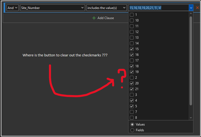

Clear out the checkmarks in the Label Class "Include the values" ?
330
03-12-2026 10:36 AM
DEAF_PROBERT_68
Honored Contributor
Curious .  Is there a way around to clear out the check marks ?
See what I screenshot of the picture.....
Thanks !
JamesPoeschel
Hi! Usually in other places you can press hold Ctrl and uncheck a box and it will uncheck all of them (like in the contents pane). But in the Definition Query UI, you cannot. One way to clear out all the check marks is to close that drop down and click backspace or delete (since the text will be highlighted by default, if not you can do Ctrl + A to highlight all) . When you open the drop down again, all the checks will be cleared out.

DEAF_PROBERT_68
Honored Contributor
Thank you ! That makes sense . I have not tried that yet but will keep that in my mind.
