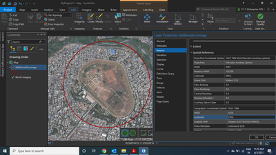

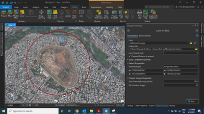

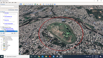

I am having an issue that has been ongoing for months now, but every time I make a buffer from a point layer that is a circle when I export as a KMZ it turns into an oval.  I have played with the settings and can't seem to get any different results.  See picture below.

Make sure the feature class geographic coordinate system should be GCS WGS 84. I have created a feature class and digitized one circle. Refer below screenshot.
Now use layer to KML gp tool to export the Kmz fir.
Here is the exported results
