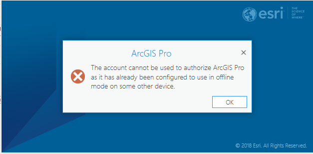

I checked out an ArcGIS Pro license to work offline (it is set up with named users). When I try to check it back in- I am asked to log into our enterprise account, which I do and then I get the following message. How do I get around this so I can use my pro license?

This is what I get when I click to open the application
Then I go to enterprise login and do that and then I get the error message that I first posted

This is good information.  Your AGOL organization was configured for Enterprise login.  Perfect!  Now open a web browser on your machine and go to www.arcgis.com.  You should be able to login using your Enterprise Login account.  Once in, are you able to see a Licenses tab?  If not, it means you do not have admin access to the org and will require and account with organization admin. If you can, go to the Licenses tab.  Do a search for your account.  If it has a red marker indicator in front of it, it means the licenses were taken offline on a system.  A green marker indicate it was used to log into a system recently.  No marker indicate it has not been used recently but is still active for use.  If it has a red marker, ArcGIS Pro is behaving as expected.  You provided an account which had licenses taken offline on a particular system.  If you are absolutely sure you did not take a license offline on another system, you can contact Customer Service to have it reset.  Then you can use the account again to log into ArcGIS Pro on any machine.

Ok- I do see a red mark by my name- how do I check the software in so I can use it? I can't open a project to work. I have even disconnected myself from the network and I still can't get it to work.
I get this from our enterprise organization
Do I need to call customer service to reset?
AmnoyAm
Yes.  Only Customer Service can reset online/offline accounts status in AGOL organization.
