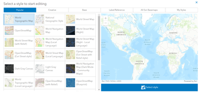

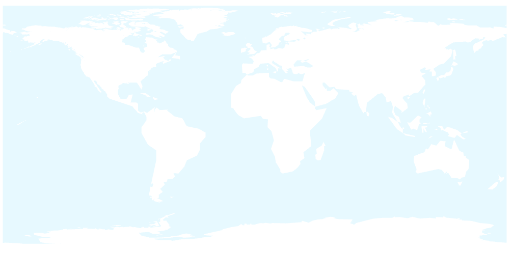

My name is Adrian. I am hoping someone can help me with changing the symbology of bathymetry that I got after using Esri's Vector Tile Style Editor. To give some background, in the Vector Tile Style Editor I used the World Topographic Map and edited it to where I only had marine bathymetry (as seen below)

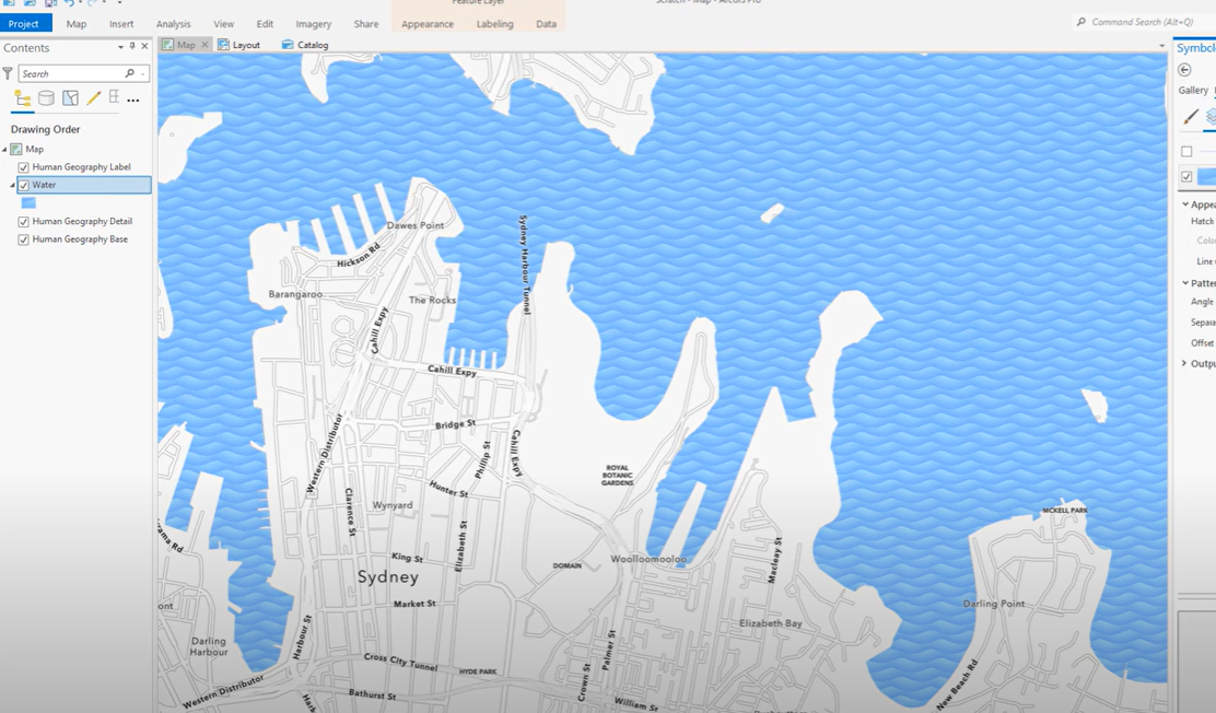

Now plan to edit the bathymetry to show as in the tutorial "Make Waves With Your Map," by John Nelson of Esri. Here is the the final product in his tutorial in the next image.
