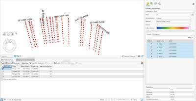

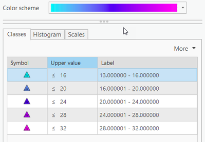

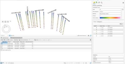

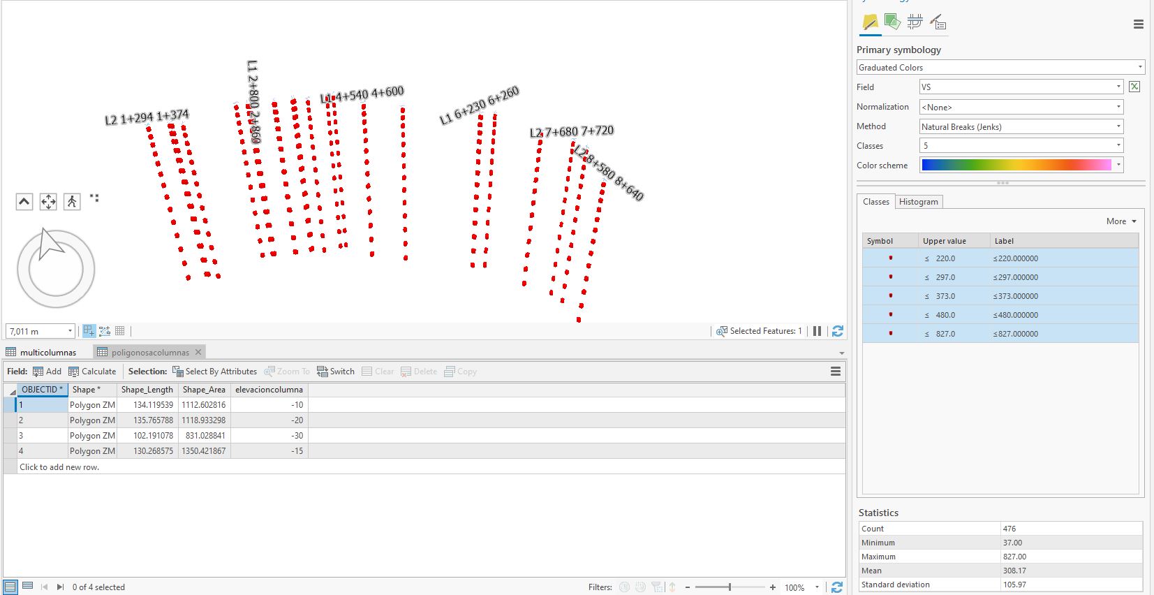

hello, there is an option in which I can change the symbol in a "feature class" of points, but it also appears with the gradient scale. since, when I change the symbol it changes to a single color, just like the other symbols. I would have to go to each class and put in another color, but not automatically.

Hi @ArmandoFreites16 ,

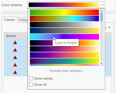

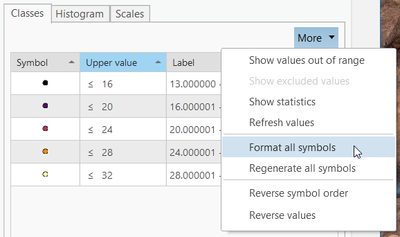

I think what you want to do is use the "Format all symbols" option and choose the symbol you'd like for your feature class.
Then, you want to choose the color scheme you want to apply again from the menu. Doing so will color the new symbols with your chosen scheme.

ArmandoFreites16

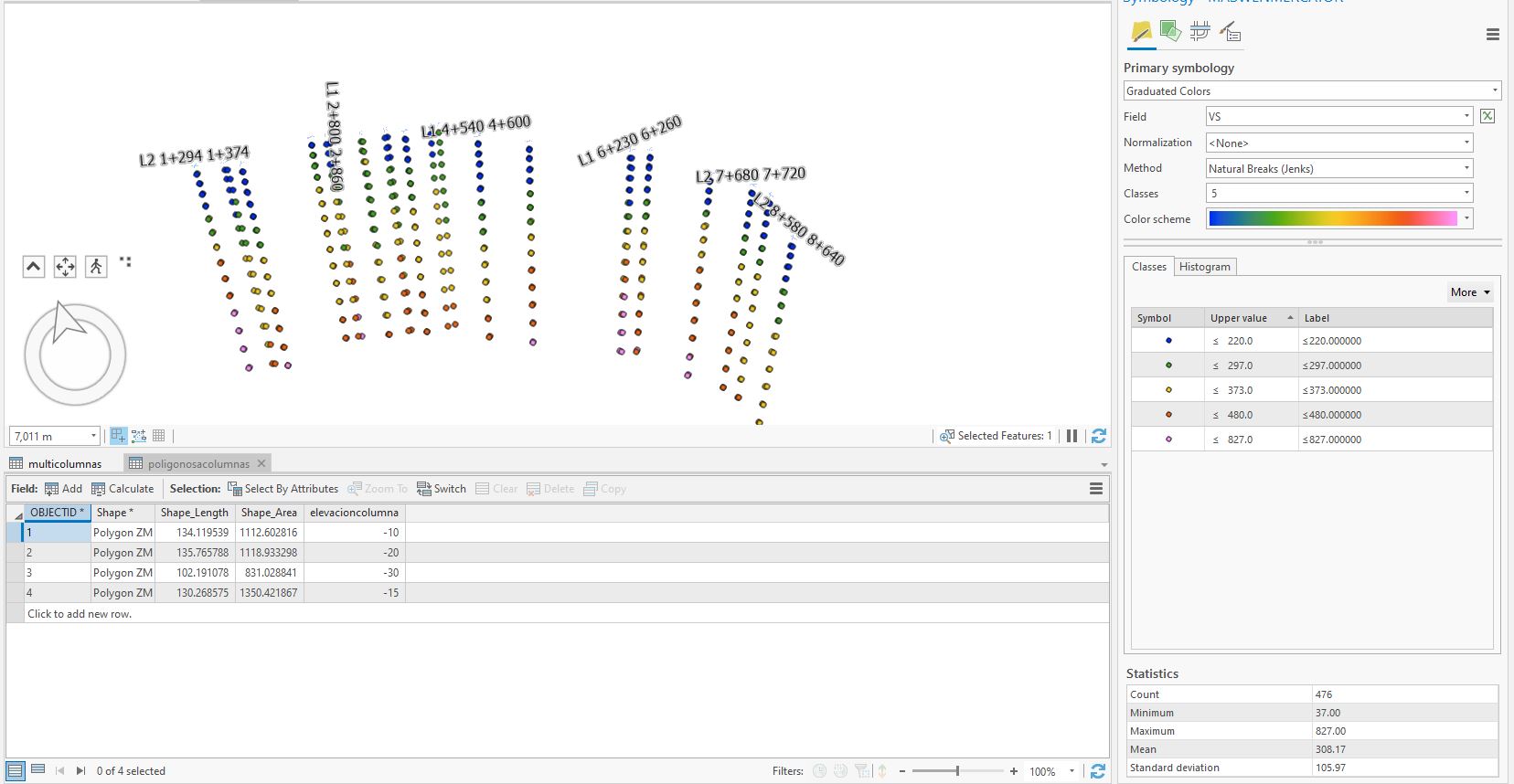

Excelllent. Yes it's the solution. I changed again "Primary symbology" but not "color scheme".
