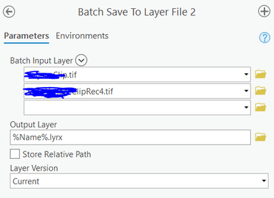

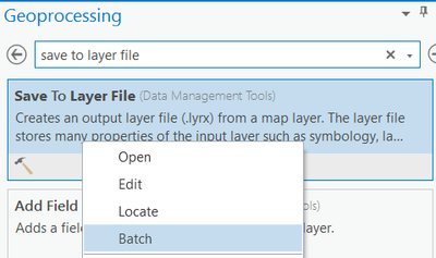

3. In Geoprocessing Pane search for "Save to Layer File" > Right-click the tool > Click Batch.
You may choose to save the Batch tool for future use.
Fill the required parameters. Select all the files from Table of Content, drag and drop to "Input Layers" parameter.
For Output Layer, choose an appropriate folder, and type %Name%.lyrx
