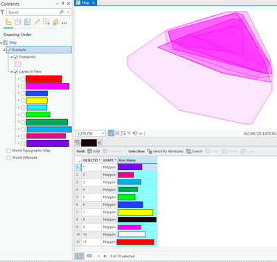

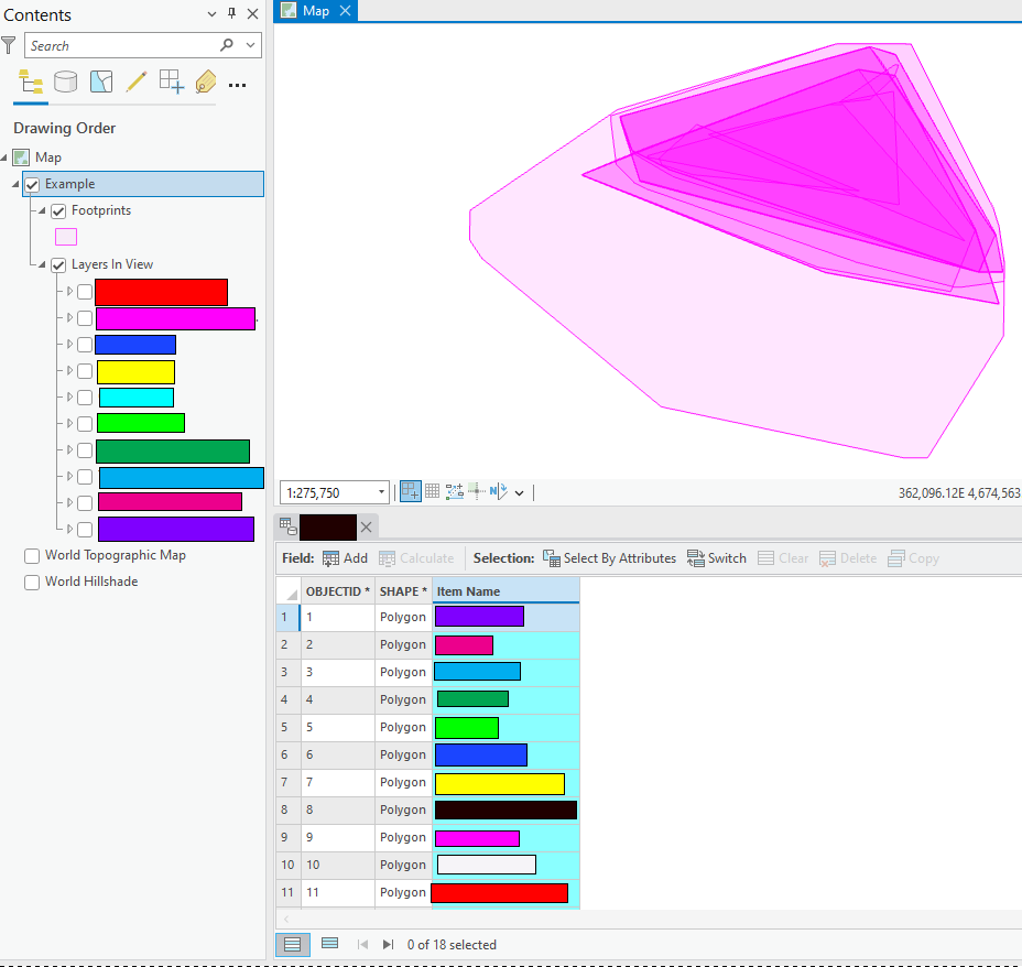

I'm experimenting with Catalog Layers and I'm wondering if it's possible to show more than 10 layers at a time with them? Some of my catalog layers have like 18 different feeder files that are all within my current extent, but only 10 max show up for me.
Is there a way to show more than 10?
In this picture, I show the entire extent of the catalog dataset, containing 18 records. Only 10 draw at a time under "Layers in View"

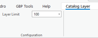

I was expecting it to be in the layer properties window (of which there are three for each catalog layer). It is instead here in the Ribbon:
