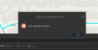

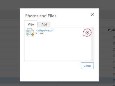

Experiencing this with ArcPro 2.8.3... trying to remove attachments from an Enterprise Portal 10.8.1 hosted feature service. Remove Attachments tool is overkill for deleting a single attachment... just thought I'd add here that it still seems to be happening.
I deleted via Portal item page:

Hey all, I'm having the same problem as @BrittanyBurson. I've tried deleting from the Attributes pane in Pro as well as from the Portal item page, to no avail.
Any updates on this issue?
