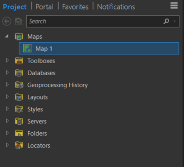

Once you have your first map set up, from the Project pane expand Maps:
Project Pane
Right-click on your first Map > Copy.

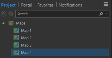

Right-click on the Maps folder in the Project pane > Paste.  Do this as many times as you need.
Copied Maps

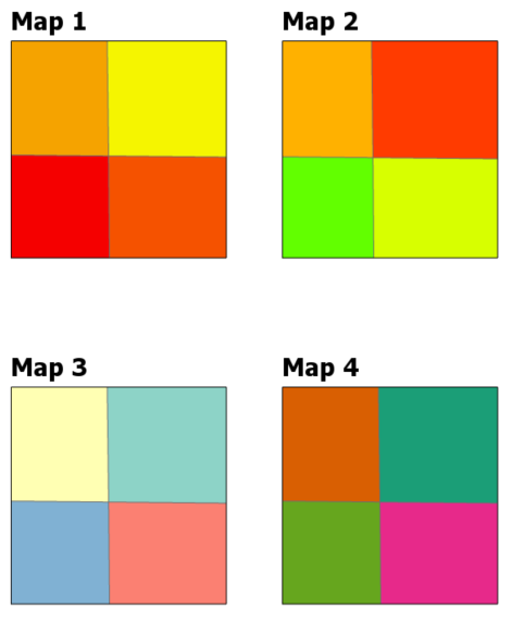

Here is my beautiful final layout!
Final Layout
