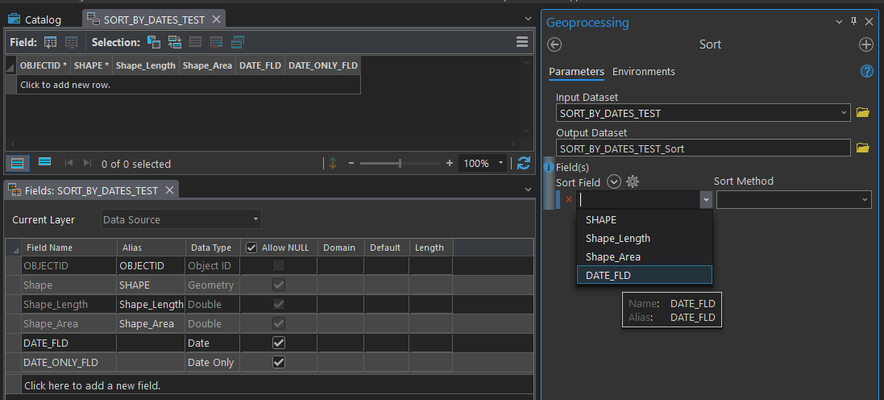

Anyone have any idea why you can sort a table based on a DATE field, but not a DATE ONLY field?
I have both field types in the example feature class below, but when it comes to the Sort tool, only the DATE field is an option. Simple oversight by Esri, or am I missing something?

It's just a matter of prioritization. It will take many releases to update all tools that take an input field to support new field types and objects. This has not happened automatically for all geoprocessing tools in the first release of the new fields (3.2).
Can you please post an enhancement idea for Sort to support the new temporal field type(s) in the Pro Ideas page, so that we can gauge user demand and prioritize accordingly?

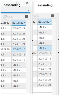

In the table no problem

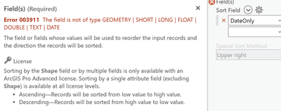

But with the Sort tool, it wouldn't even show the field name, so I entered it manually and got this error message
The operative word may be Date... and DateOnly isn't Date
