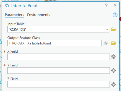

I added a table to my Pro map (version 3.5.2) and I can't get the XY Table to Point tool to recognize the X and Y Fields. It just won't pull them in so I can run the tool:
There are plain Lat Long fields. I made sure they're formatted to numeric w/6 decimal places. The field names are just Lat and Long. None of the field names have spaces or special characters or even numbers in them. All of the field headers/ names are formatted as text. I restarted Pro and then restarted my computer.
I do this all the time and I can't figure out why it's not working. I did download the original table as a giant csv, which I opened in Access, selected out the entries I was interested in, and copied those into Excel to create my table. Is there something residual from that that's messing me up?
Thanks for any insights!!

@AvaFarouche Looks like you are directly using the Excel Table. Does your other processes work fine with data in Excel - there are specific instructions to Work with Microsoft Excel files in ArcGIS Pro
If the required drivers are installed, try using Excel to Table  and use the GDB table as input to XY Table to Point tool.

show a couple of rows of the table, perhaps, they ended up getting formatted as text (left_justified)

Hmm.. they are left justified. But they are also formatted as numeric. I experimented w/changing justification, just in case but it didn't change anything. Thanks for the suggestion!

you can't just change the justification.
Go back to excel, format those fields as numeric and save the files as a *.csv, or do as Ayan says and use the Excel to Table tool
If you can't do it in excel, then you will have to add 2 new fields to your table and use the field calculator to convert the Long and lat fields to numeric  (eg make a Long_ and Lat_ field as type double, then use the field calculator to convert from text to numeric Long_ = float(Long) etc

Well, they were formatted as numeric all along. But saving as csv solved the problem. Thanks for the tips!

I use Excel all the time! I guess I have gotten sloppy. I tried Excel to Table and that didn't fix the problem, but then I just saved my original spreadsheet to a csv and that worked! Thank you!!

good catch if it is an excel file since a delimited file is expected

Yes, that was the problem. I use Excel all the time!! I have gotten sloppy with that, but it generally works. I saved it to csv and that solved the problem. Thanks for chiming in!
