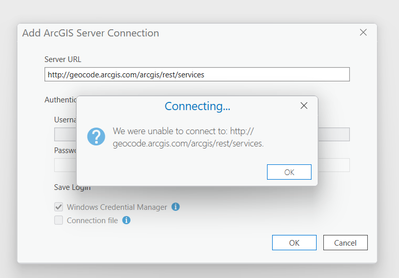

Hello, same issue. I tried adding arcgis server, this shows up
