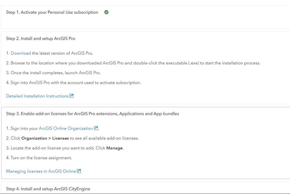

When I click on the fulfillment page link in my order fulfillment email, this is what I get:
When I go to "sign into ArcGIS online organization", it comes up as an online public account with limited functionality.  I thought the ArcGIS personal use license included ArcGIS online?  Very confusing!

WilliamJones9
Thank you for your response.  I reached out to tech support and they provided me an authorization link to convert my ArcGIS online account from public to organizational.  Apparently ESRI should have sent me an email with this link when I purchased my Personal Use license, but I did not receive it.  I have a friend in the same situation, so it may be a glitch in ESRIs purchase system when an individual is buying a personal use license.
