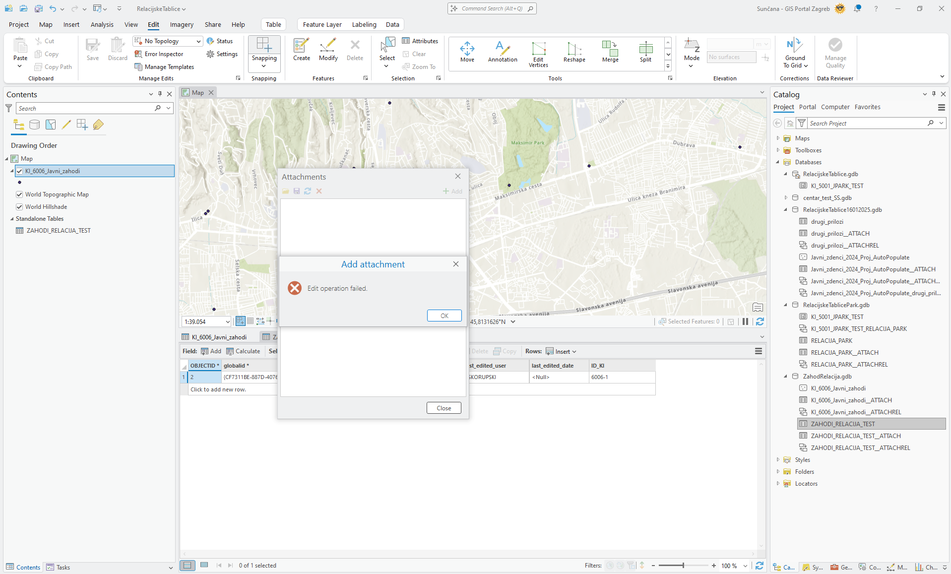

Can not add attachment to standalone table with error 'Edit operation failed' (ArcGIS Pro)
476
01-20-2025 01:01 AM
Sunnny
I've created feature layer and standalone table in arcgis portal, then created gdb in arcgis pro.
I've imported feature class and table i gdb, enabled attachments through properties - manage - attachments.
I've also enabled Editor tracking.
I've established relation between feature class and table.
 When I open table, Manage attachment option i enabled and I can choose files I want to attach, but when i click 'open' I get error message 'Edit operation failed.'
Sunnny
OK I've solved this.
I was trying to attach opened file.
