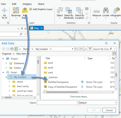

Yes, in ArcGIS Pro you can add the vector tile layer that you saved using the vector tile style editor.   Click Add Data and you should be able to find the vector tile layer that you created in 'My Content'.

It works in ArcGIS Pro.  Thanks so much.

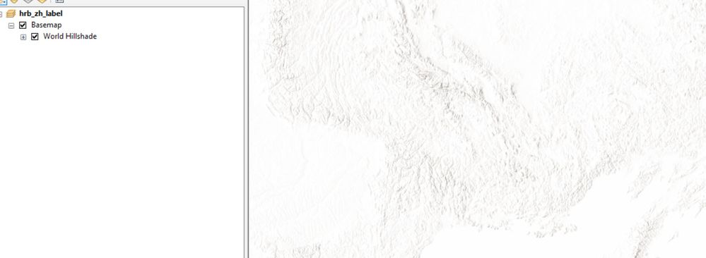

In arcMap(10.8), the web map(with one vector tile layer) is added but not displayed.  As the screenshot below.vector tile issue.jpg
