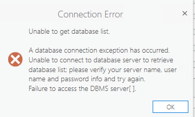

I'm encountering an odd issue with one particular SQL Server database. This database is not managed by me, it is for another application, but I have read access to a handful of tables in the DB. I can connect to the database just fine from ArcGIS Desktop and SQL Server Client, but if I attempt to connect to the same database from Pro using the same credentials on the same machine, it fails. The general error message is that a database connection exception has occurred:
