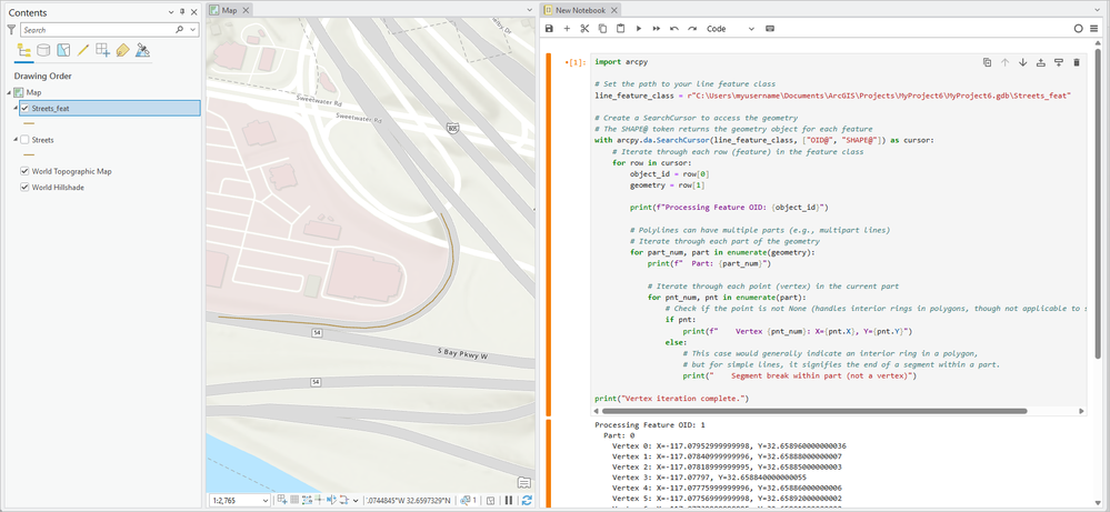

I don't know of a tool that would do this for you out of the box.
You could write something in Python.
You can iterate over features in a feature class using a search cursor, and you can iterate over parts of a geometry to get the individual vertices of a line.  With this, you could iterate over the line, get each vertex, draw a line segment starting and ending at the appropriate length between that vertex  in the direction of the previous one.
import arcpy
# Set the path to your line feature class
line_feature_class = r"C:\Users\myusername\Documents\ArcGIS\Projects\MyProject6\MyProject6.gdb\Streets_feat"
# Create a SearchCursor to access the geometry
# The SHAPE@ token returns the geometry object for each feature
with arcpy.da.SearchCursor(line_feature_class, ["OID@", "SHAPE@"]) as cursor:
    # Iterate through each row (feature) in the feature class
    for row in cursor:
        object_id = row[0]
        geometry = row[1]
        print(f"Processing Feature OID: {object_id}")
        # Polylines can have multiple parts (e.g., multipart lines)
        # Iterate through each part of the geometry
        for part_num, part in enumerate(geometry):
            print(f"  Part: {part_num}")
            # Iterate through each point (vertex) in the current part
            for pnt_num, pnt in enumerate(part):
                # Check if the point is not None (handles interior rings in polygons, though not applicable to simple lines)
                if pnt:
                    print(f"    Vertex {pnt_num}: X={pnt.X}, Y={pnt.Y}")
                else:
                    # This case would generally indicate an interior ring in a polygon,
                    # but for simple lines, it signifies the end of a segment within a part.
                    print("    Segment break within part (not a vertex)")
print("Vertex iteration complete.")
