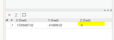

I need to populate the Z Geometry Attribute of a point feature class.
I have the Z value as a field in the attribute table.
How can I script this process to avoid having to hand type the elevation valves when I have the data already?
Pro 2.7, file gdb.
Field in Attribute table:
