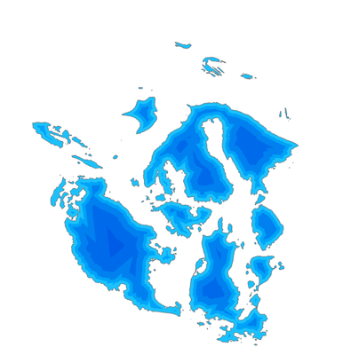

I'm not entirely sure what you're going for, but check out Python CIM access—ArcGIS Pro | Documentation

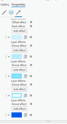

You could also do either gradient fills, or multiple layers of donut?
This was pretty quick to set up and easy enough to adjust
4 Layers of donuteach donut layer is twice the size of the one before it (4>8>16>32), and at an increasing transparency of the same brighter color than the base color.
