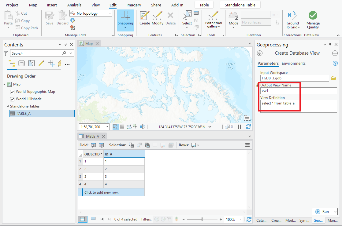

I've created a standalone table in a file geodatabase. And I've created a view on the table:
select * from table_a
The view has been created successfully:
However, when I try to add the view to the map, I get an error:
Failed to add data, unsupported data type. vw1
And I can't rename the view. I get a blank error message:

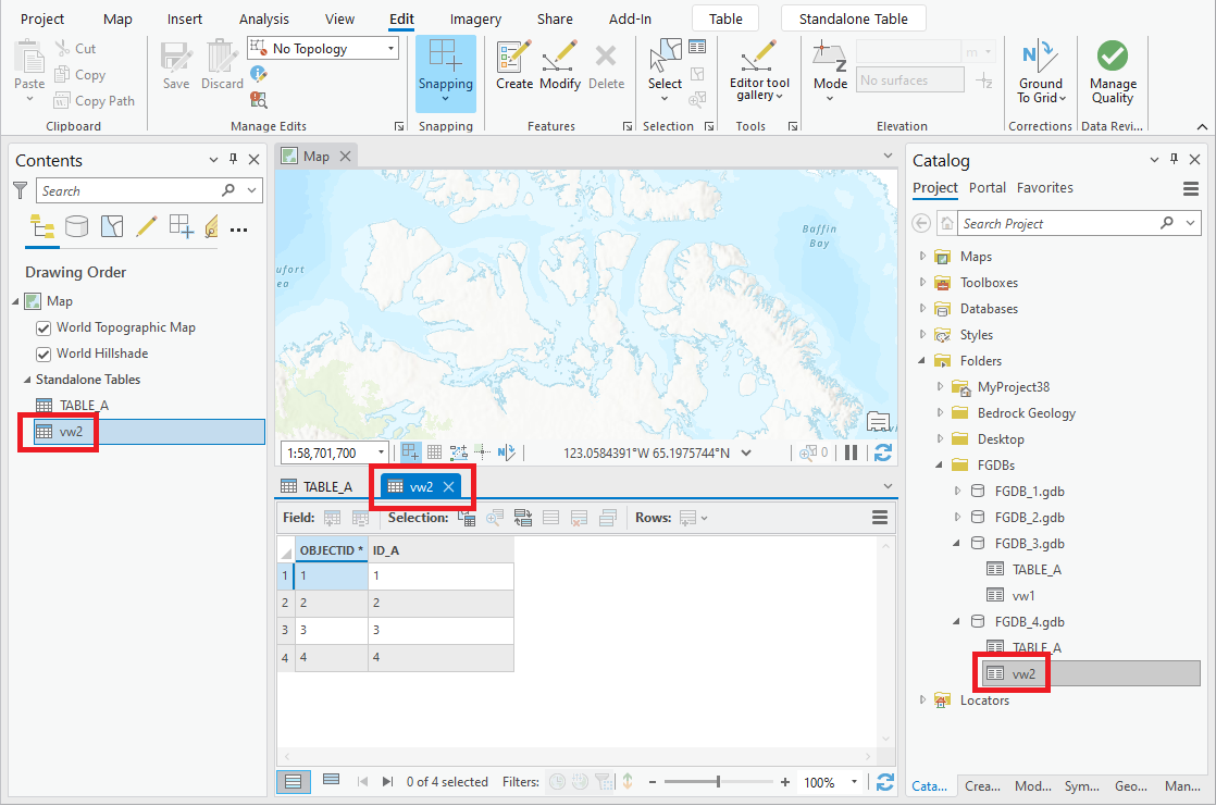

Workaround:
Copy the table to a new file geodatabase and create a view on the new FGDB table.
Now, I can add the view in the new FGDB to the map without issue.
But I don't know why copying the table to a new FGDB fixes the issue.
