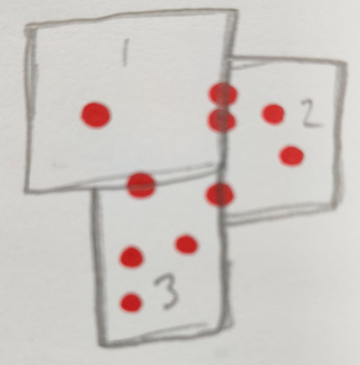

I want to count some houses that are within administrative boundaries. The problem is, that some houses sit on the borderline of 2 or more polygon boundaries. I want to avoid double counts.
This is the ilustration:
What I want to achieve, for example:
Poly 1 contains 4 buildings.
Poly 2 : 3.
Poly 3 : 3.
So, in total, there are still 10 buildings.
How can I achieve this?

With something like 'select by location' it may be the case where you have to compare 2 runs of the tool with
'within' versus 'within Clementini'
Select By Location graphic examples—ArcGIS Pro | Documentation
in the Clementini case, points exactly on a boundary aren't counted, so you could isolate those points and modify the number counts for the alternate method
