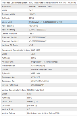

CameronRex1
Wow, totally don't remember this post. But it appears that I found a working solution. In my quick test with your exact point, it works. (Note: I just did an edit to pull from the Geometry, instead of a calculated value in the attribute table).
Try This:
// === Arcade Expression ===
// Source SR: NAD83 / Iowa North (ftUS) — WKID 3417
// LCC(2SP) params from EPSG: lat0=41.5°, lon0=-93.5°, sp1=43°16'00", sp2=42°04'00"
// False Easting/Northing in US survey feet.
var FE_ft = 4921250.0;        // false easting (ftUS)
var FN_ft = 3280833.3333;     // false northing (ftUS)
var lat0_deg = 41.5;          // latitude of origin
var lon0_deg = -93.5;         // central meridian
var sp1_deg  = 43.2666666667; // standard parallel 1 (43°16')
var sp2_deg  = 42.0666666667; // standard parallel 2 (42°04')

@BenWagner3 You can try the following (I am not entirely sure what Iowa State Plane North you are using, so I have assumed WKID: 3417). I have tested something similar in another state plane and was able to get correct results. (If you are using a different WKID, let me know and I can change it up.)
// === Projection parameters for NAD83 StatePlane Iowa North FIPS 1401 (US Feet) ===
var lat0 = 41.5;
var lon0 = -93.5;
var phi1 = 43.2666666666667;
var phi2 = 42.0666666666667;
var E0 = 4921250.0; // False easting (ft)
var N0 = 3280833.3333; // False northing (ft)

I'm just now getting back to this project. The script you did is not quite working. Punching the returned coords into Google Maps takes me out to a spot in Wisconsin. I'm working with a sample parking sign. Here is the correct coordinates in Iowa State Plane North and lat/long:
Here is the lat/long that is being returned by the script:
Here is the spatial reference of the feature class:
-Ben
