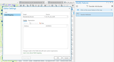

ArthurPoon
Are you talking about this Transfer Attributes tool in the Modify Features menu?
It appears that yes, it isn't restricted to geometry type, but it looks like you can only edit one feature at a time.
