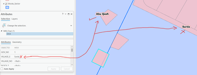

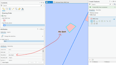

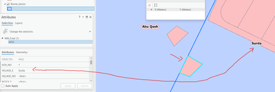

Pictures for clarification:
1. Create a plot of land within the neighborhood and take the correct neighborhood name
2. create a plot of land that touches more than one neighborhood, the name of the neighborhood that contains the plot has been taken, and this is correct
3. The third case is where I would like to modify the code for such cases:
A plot was created that intersects a few meters with a neighboring neighborhood, and as a result the wrong name was taken
* The name should be Abu Qash, not Surda
What is the correct code in this case?
