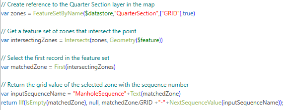

I am trying to create an attribute rule for a point feature class (Manholes) in which I want a field (FacilityID) to populate based on the combination of intersection with a polygon grid (Quarter Section) and a Database Sequence. For example, if I create a new point feature in grid 564 and the point is the 55th point in grid 564, I want the attribute rule to populate the FacilityID field with 564-55. I also want this rule to work with any grid, each which has its own Database Sequence counting the number of points. Here is what I have so far:

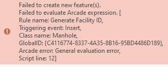

This script fails with the following error:

Does anyone know what might be causing the inputSequenceName to fail when passed into the NextSequenceValue instead of the hard coded string?

// The error is in this line
var inputSequenceName = 'ManholeSequence' + Text(matchedZone)
// matchedZone is a feature set, not a field!
// Try this:
var inputSequenceName = 'ManholeSequence' + Text(matchedZone.GRID)
Have a great day!
Johannes

Thank you so much for the reply! I appreciate you showing me how to insert the code sample. Thanks for clarifying matchedZone is a feature set. Using your revision, I got my attribute rule to work the way I want. The only thing I had to change was removing the inputSequenceName variable and directly including the 'ManholeSequence' + Text(matchedZone.GRID) in the NextSequenceValue function. When I passed in the variable, it threw a null return error. Anyways, it's working now, so thanks again for the help!
